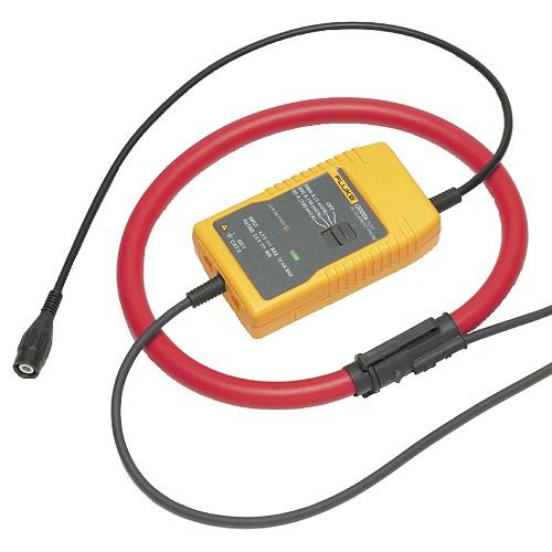

Fluke i6000sFlex vahelduvvoolumõõturi6000sflex on vahelduvvooluandur, mis kasutab Rogowski põhimõtet. Seda saab kasutada kuni 6000 A voolu mõõtmiseks, kui seda kasutatakse koos ostsilloskoopide, salvestajate või andmelogijatega. Paindlik ja kerge mõõtepea võimaldab kiiret ja lihtsat paigaldamist raskesti ligipääsetavates kohtades.Fluke i6000sFlex AC Current ProbeElectrical CharacteristicsCurrent ranges60 A / 600 A / 6000 A AC rmsOutput sensitivity (AC coupled)50 mV /5 mV / 0.5 mV per ALoad impedance100 kOhm minimumAccuracy (at +25°C)±1% of range (45 – 65 Hz)Linearity (10% to 100% of range)±0.2% of readingNoise8 mV AC rms (60 A)2 mV AC rms (600/6000 A)Frequency range10 Hz to 50 kHz (-3 dB)Phase error< ±1° (45 – 65 Hz)±10° (at 20 kHz)Position sensitivity (with cable > 25 mm from the coupling)Position sensitivity: From 1% up to 3% of range with cable, depending on distance from the center (see figure left). Measurements closer than 25 mm from the coupling are typically greater than 3% of range.External wire influence: 1% (-40 db) of external current >200 mm from head.External field (with cable > 200 mm from the head)±1% of rangePower supply2 x AA MN 1500 LR6 alkaline400 Hours, low battery indicator or dedicated ext power supplyTemperature coefficient±0.08% of reading per ° CWorking voltage (see Safety Standards section)600 V AC rms or DCGeneral CharacteristicsHead cable length (double insulated)610 mm (24 in) I6000s Flex-24915 mm (36 in) I6000s Flex-36Head cable diameter14.3 mmHead bend radius38.1 mmCable length (head to electronics)2 mOutput connection0.5 m cable terminated with safety BNC connectorSupplied with 4 mm safety plug adaptorOperating temperature range-20 to +90°C (head)-20 to +85°C (electronics)Storage temperature range-40 to +105°C (head)-20 to +85°C (electronics)Operating humidity15% to 85% (non condensing)Weight180 g (head), 190 g (electronics)Safety StandardsBS EN 610101: 2001BS EN 610102-032: 2002BS EN 61010031: 2002600 V rms, Category III, Pollution degree 2EMC standardsBS EN 61326: 1998 +A1, A2, and A3Use of the probe on uninsulated conductors is limited to 600 V AC rms or DC and frequencies below 1 kHz
