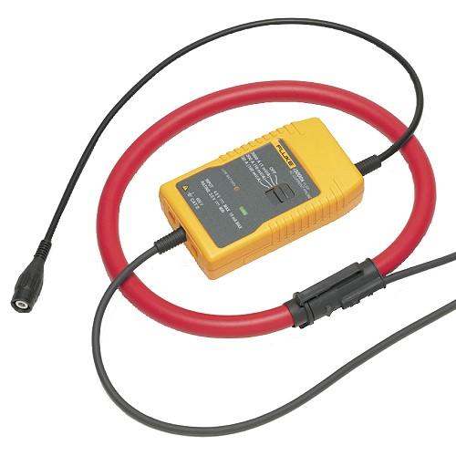

Fluke Ampertangid AC 6000A (Rogowski pritnstiip) max juhe 275mm
Tootekood: EE-100-157-297
Fluke I6000S-FLEX-36 PakkumisedFluke i6000s Flex on vahelduvvooluandur, mis kasutab Rogowski põhimõtet. Seda saab kasutada kuni 6000A voolu mõõtmiseks, kui seda kasutatakse koos ostsilloskoopide, salvestajate või andmelogijatega. Paindlik ja kerge mõõtepea võimaldab kiiret ja lihtsat paigaldamist raskesti ligipääsetavates kohtades.Fluke I6000S-FLEX-36 SpecificationsElectrical CharacteristicsCurrent Ranges60 A / 600 A / 6000 A ACRMSOutput Sensitivity (AC coupled)50 mV /5mV / 0.5mV per ALoad Impedance100 kOhm minimumAccuracy (at +25°C)±1% of range (45 - 65 Hz)Linearity (10% to 100% of range)±0.2% of readingNoise8mV ACRMS (60 A) 2 mV ACRMS (600/6000A)Frequency Range10 Hz to 50 kHz (- 3 dB)Phase Error< ±1° (45 - 65Hz), ±10° (at 20 kHz)Position Sensitivity (with cable > 25mm from the coupling)±2% of rangeExternal field (with cable > 200mm from the head)±1% of rangePower Supply2 x AA MN 1500 LR6 alkaline 400 Hours, low battery indicator or dedicated ext power supplyTemperature Coefficient±0.08% of reading per CWorking Voltage (see Safety Standards section)600 V ACRMS or DCGeneral CharacteristicsHead Cable length-(double insulated)610mm (24") I6000s Flex-24915mm (36") I6000s Flex-36Head Cable Diameter14.3 mmHead Bend Radius38.1 mmCable length (head to electronics)2 metersOutput Connection0.5 m cable terminated withsafety BNC connectorSupplied with 4mm safety plugadaptorOperating Temperature Range-20 to +90 °C (head)-20 to +85 °C (electronics)Storage Temperature Range-40 to +105 °C (head)-20 to +85 °C (electronics)Operating Humidity15% to 85% (non condensing)Weight180 g (head), 190 g (electronics)Safety StandardsBS EN 610101: 2001BS EN 610102-032: 2002BS EN 61010031: 2002600VRMS, Category III, Pollution Degree 2NoteUse of the probe on uninsulated conductors is limited to 600 V ACRMS or DC and frequencies below 1 kHz.EMC StandardsBS EN 613261998 +A1, A2, & A3
