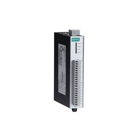

Input/Output Interface Digital Input Channels 6 Isolation 3k VDC or 2k Vrms Relay Channels 6 Buttons Reset button Digital Inputs Connector Screw-fastened Euroblock terminal Counter Frequency 250 Hz Digital Filtering Time Interval Software configurable Dry Contact On: short to GND Off: open I/O Mode DI or event counter Points per COM 6 channels Sensor Type Dry contact Wet contact (NPN or PNP) Wet Contact (DI to COM) On: 10 to 30 VDC Off: 0 to 3 VDC Relays Breakdown Voltage 500 VAC Connector Screw-fastened Euroblock terminal Contact Current Rating Resistive load: 5 A @ 30 VDC, 250 VAC, 110 VAC Contact Resistance 100 milli-ohms (max.) Electrical Endurance 100,000 operations @ 5 A resistive load Initial Insulation Resistance 1,000 mega-ohms (min.) @ 500 VDC Mechanical Endurance 5,000,000 operations Pulse Output Frequency 0.3 Type Form A (N.O.) power relay Note Ambient humidity must be non-condensing and remain between 5 and 95%. The relays may malfunction when operating in high condensation environments below 0°C.
Part nr: ioLogik E1214-T
